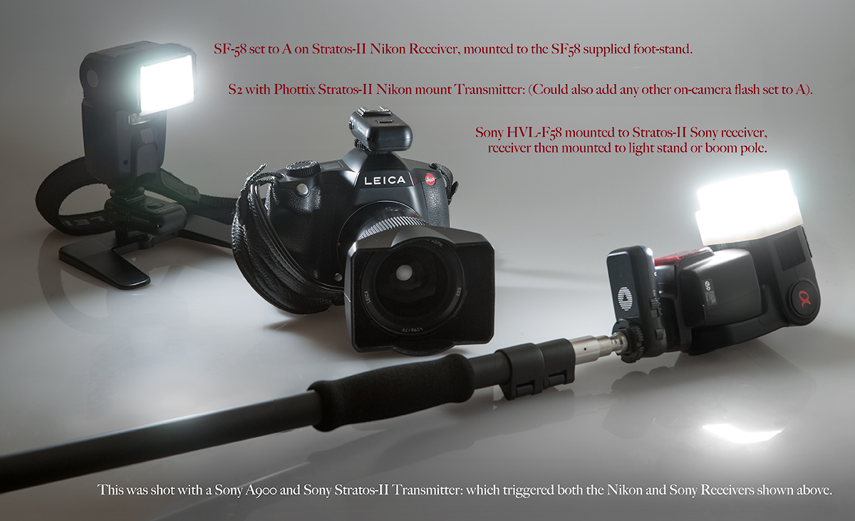

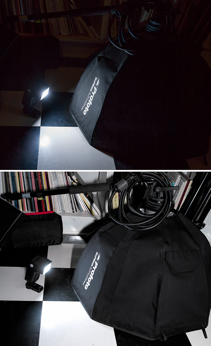

    I’m back!
    Okay, here is a demo of using the Phottix Stratos-II Nikon Transmitter in the S2 hot-shoe with a SF-58 set to A then mounted on top of the Stratos-II. Plus another SF-58 off-camera set to A mounted on a Stratos-II Nikon Receiver that’s in the SF-58 supplied stand-foot.
    Top image shows the on-camera SF-58 shut off to evaluate the off-camera light … then the bottom shot shows the on-camera SF-58 turned on to provide the over-all lighting … I’ve found this to be much faster than having everything set to manual.
    The second photo shows use of different brands of flash … the captions explain it.
    In fact, if you use another brand of camera, like Nikon, Canon or Sony … that is the Phottix Stratos-II configuration to get. The bonus is that when used with the other camera, you CAN set the on-camera speed-light to TTL and the Stratos-II will pass through the TTL data, and keep the on-camera flash TTL … very helpful for fill when using a strong off-camera directional light.
