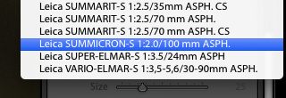

    Found this in Lightroom 5.5 under the lens profiles –
    Okay, fess up – who has it?

    Ha! Well well, is this prophetic? I had to check LR5.5 myself and indeed it’s listed. This may get interesting.

    anGy
    My laptop lightroom version was 5.4. No 100mm Summicron listed.
    I’ve just updated to 5.5 and the 100mm is now listed.
    This is definitively new 😎

    I decided to pull out all the Leica S lens entries to see if there was a pattern to the date string. The date string appears to be a serial number and lenses are added/updated in batches. Each lens does NOT have its own unique date stamp. Leica R and M lenses shared the same ModifyDate, so it seems Adobe assigns this modify date – probably when the do Camera Raw updates. Other makers equipment share the same data stamps (Canon, Sigma, etc). The 100/2 was the newest addition (of the Leica date batches) with the 45/2.8 being in the same batch. The following is a cleaned up summary:

    Did some more digging in System Library and found the actual Adobe Lens Profiles for Camera Raw and there is a 100/2 .lcp file from June 18, 2014 with a complete list of lens correction parameters. So it’s unlikely the 100/2 entry above is just a placeholder. Here’s the Adobe lens correction file name for the 100/2 (Mac OS X) –
    Leica Camera AG (Leica SUMMICRON-S 100 mm f2 mm ASPH.) – RAW.lcp
    This all points to the lens existing and developed far enough that Leica wanted to play with the lens in Lightroom. There is no field that says “commercial release date” and “MSRP” 🙂
    It was interesting looking at the lens correction file in a text editor – it has 12 sets of data – each set is for a different focus distance. The focus distance range from .7 to 100000003318135351409612647563264. I assume that’s meters. And evidently Leica has defined infinity for us 🙂 LOL
