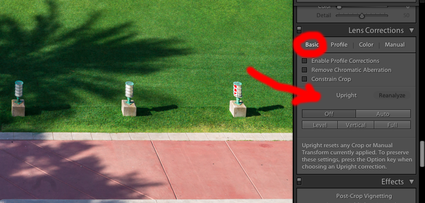

There is a image correction called “upright” which is perspective correction. It is very handy for architectural work.
Upright straightens your photos automatically, based on the image content. It looks for straight lines like buildings and horizons, leveling tilted photos and fixing keystone distortion on buildings. Sure you can do this slowly in LR or Photoshop, but this is faster.If you were following my architectural work in 24mm in use, you heard me complain that getting the camera perfectly level and aligned even with a bubble level was a challenge. Using the 24mm will showcase any leveling problem. Correcting for this in LR5 got easier.
Finding the control is not obvious. You have to click “basic” to get the “upright” button to even appear.

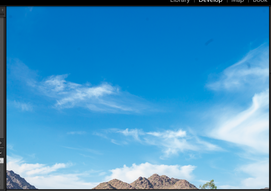

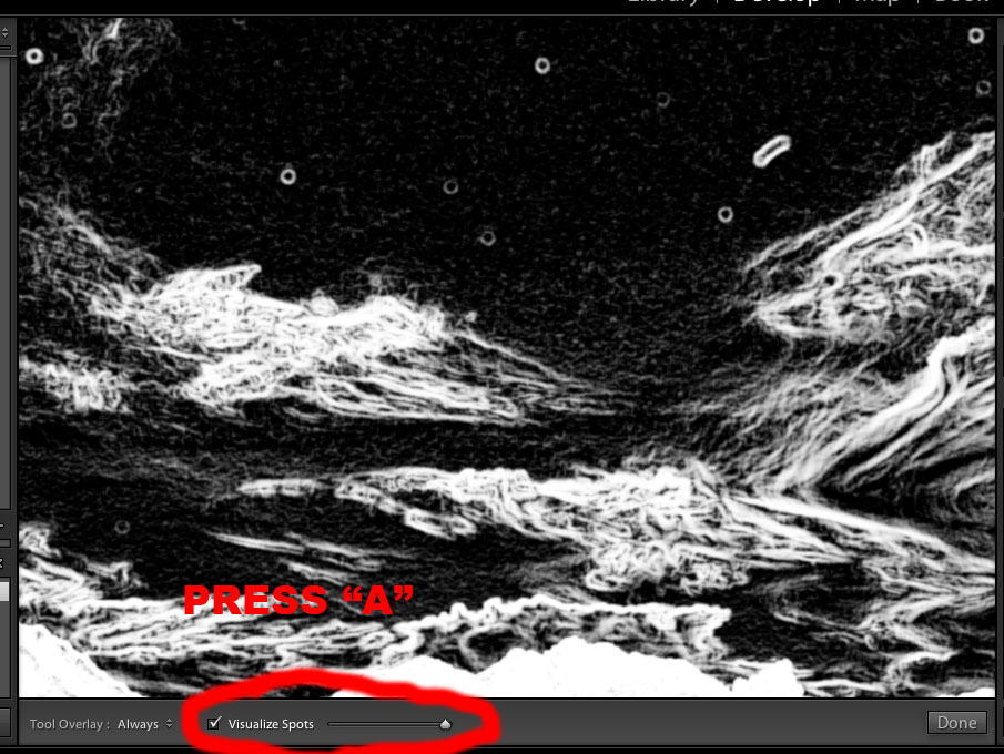

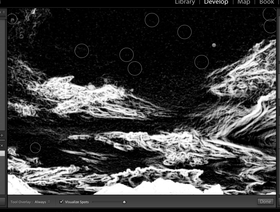

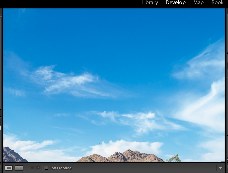

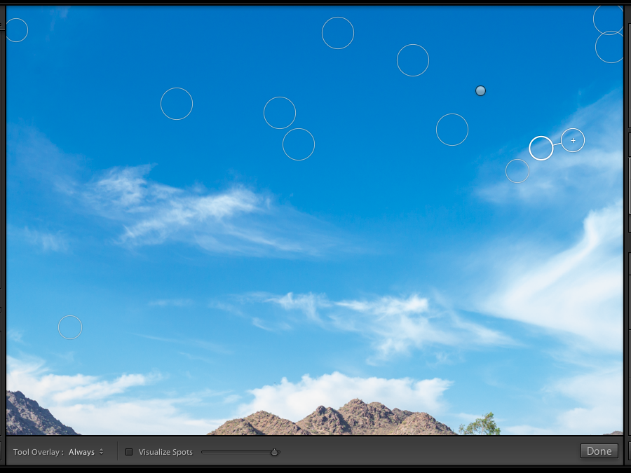

Leica M, Leica S, Leica CLOfflineWe all do dust spotting.
LR5 has the ability to aid me in identifying dust spots from dust on the sensor. If you click on the clone/heal tool, you can then merely press “A” and the scene switched to a high contrast B&W view that allows for more easily seeing where I need cloning out or healing the dust spots. Press “A” again and the image returns to normal.
Also the tool now allows me to drag the tool to match a spot that is more of a lash than a spot. Always could do that in Photoshop, now I can do it in LR5.
All this is faster than sending the S2 back to Germany for them to clean my sensor, as I fear to touch the sensor myself. I do use a blower to blow dust off the sensor, but never expect that to be perfect.

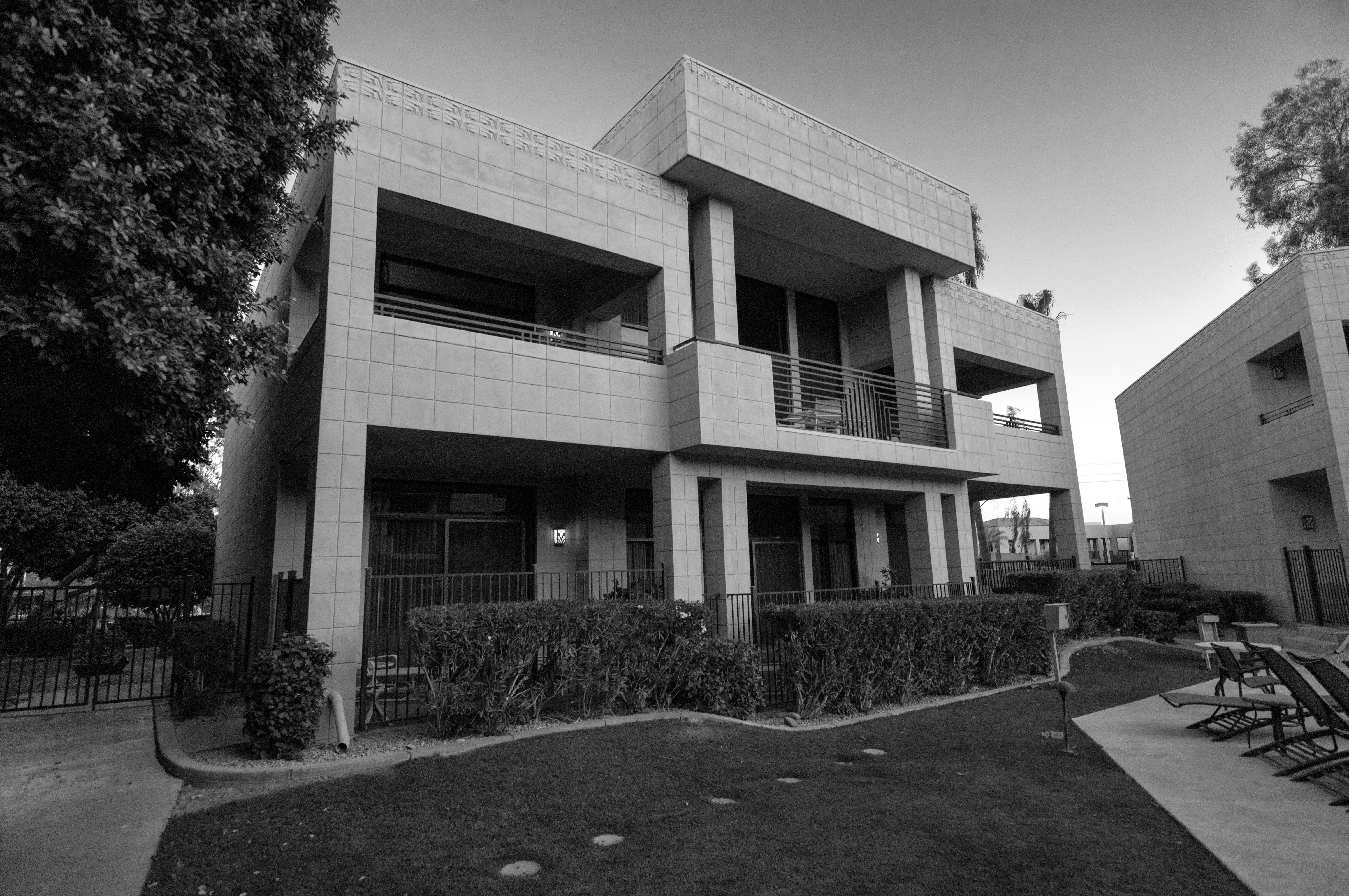

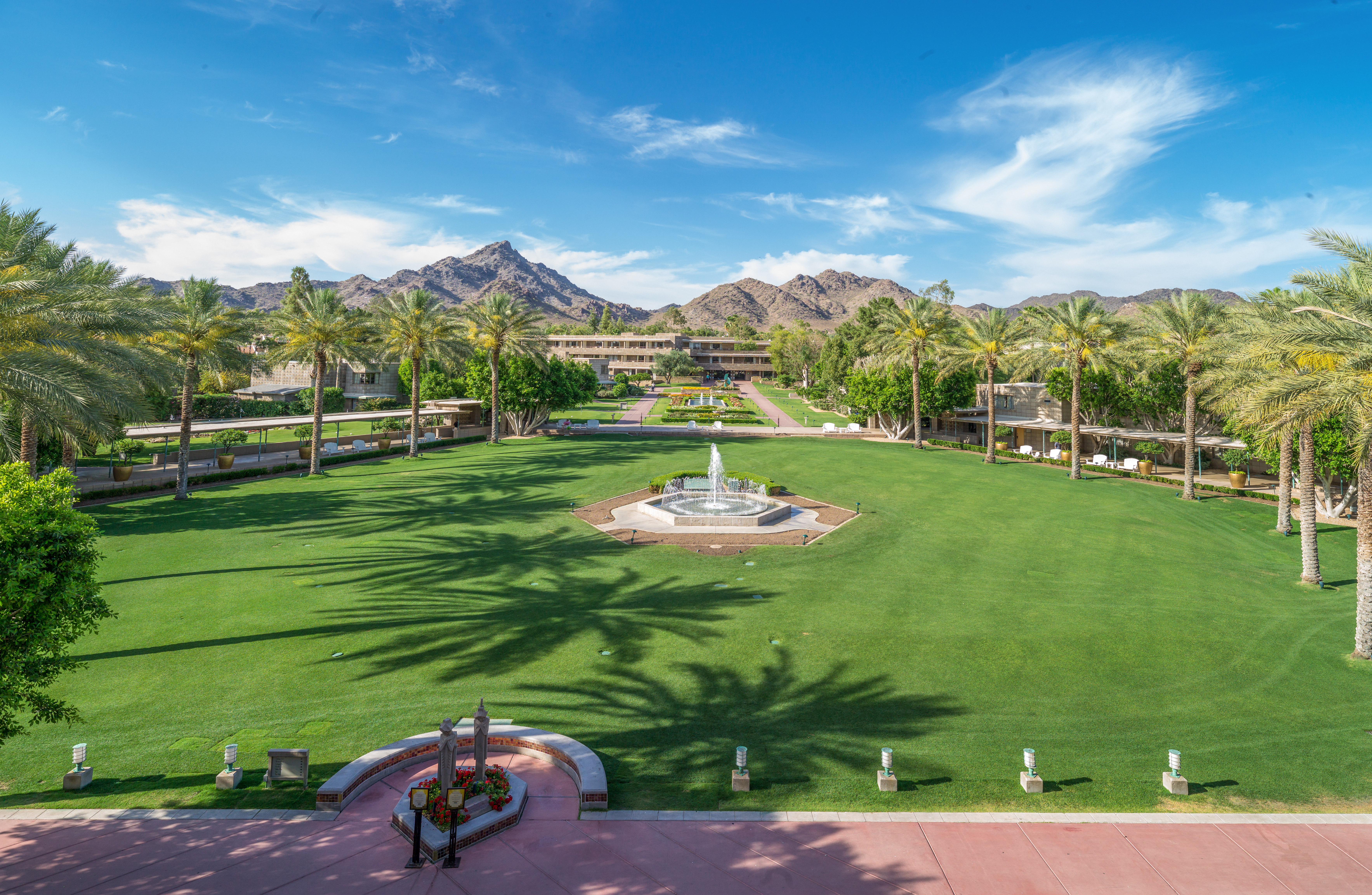

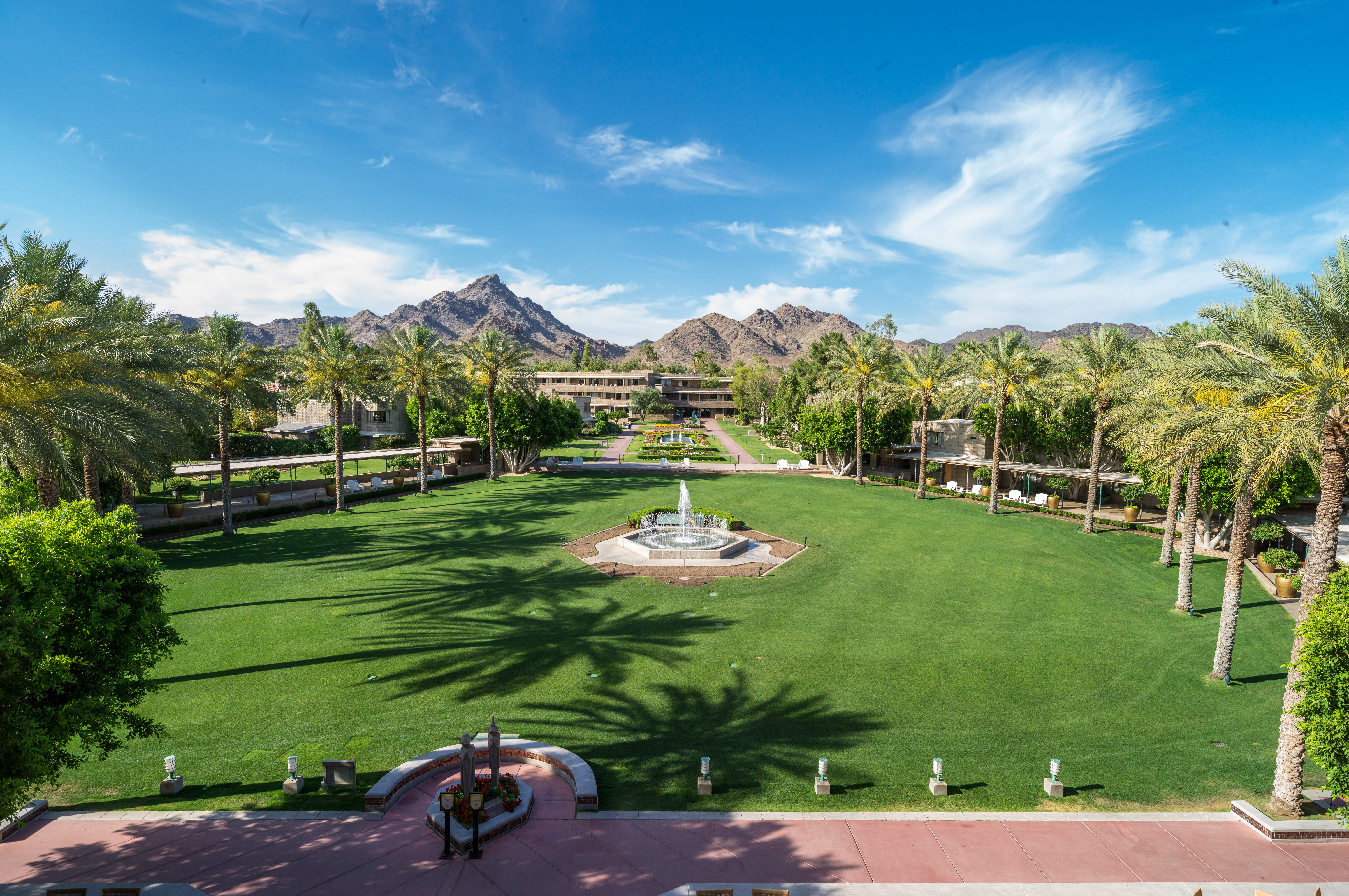

- May 24, 2013 at 5:03 am #3899Jack MacDEstablished MemberUSA, St. Louis, MO and Phoenix, AZJoin Date: Jun 2011Posts: 367Currently using:

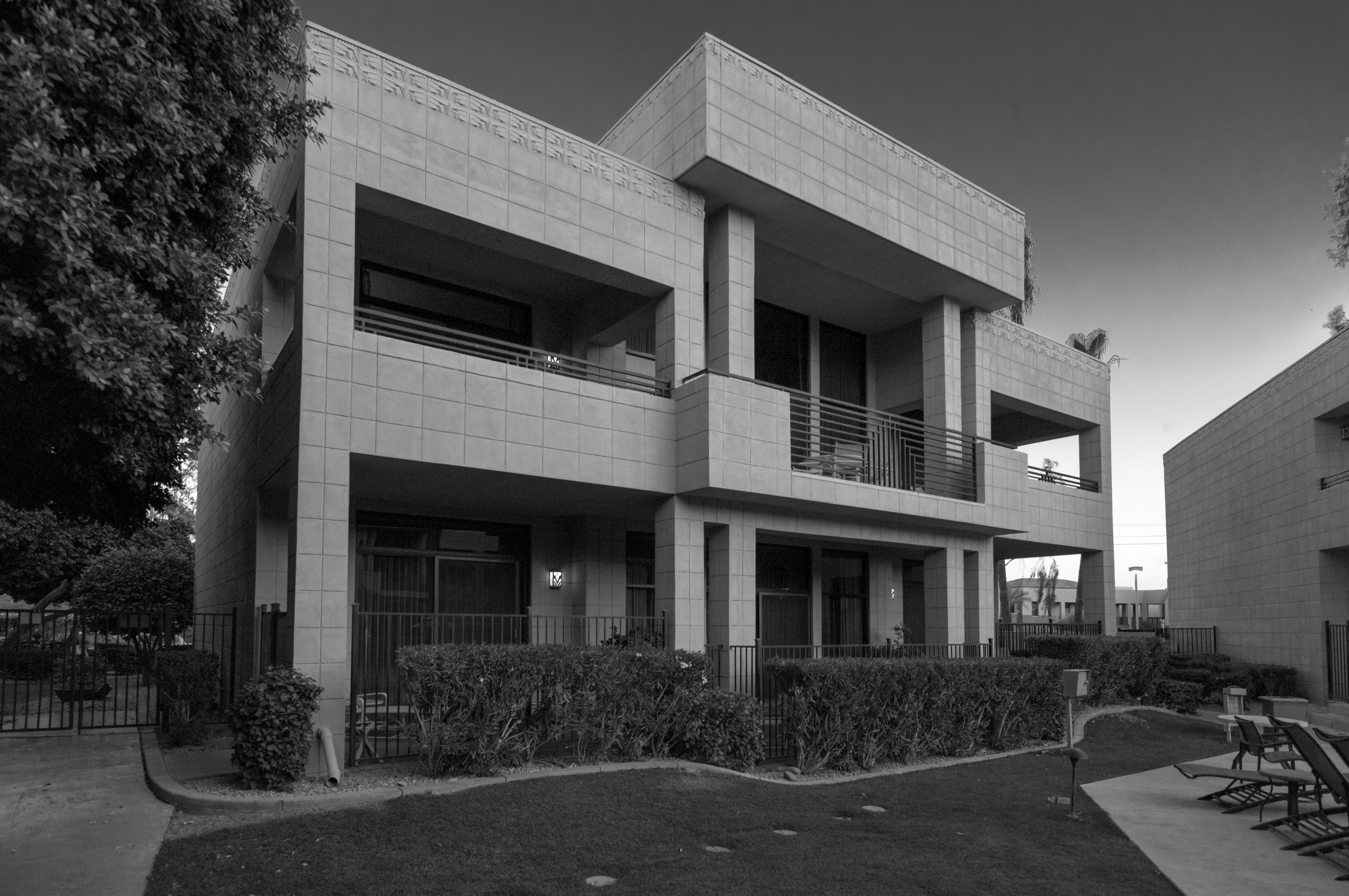

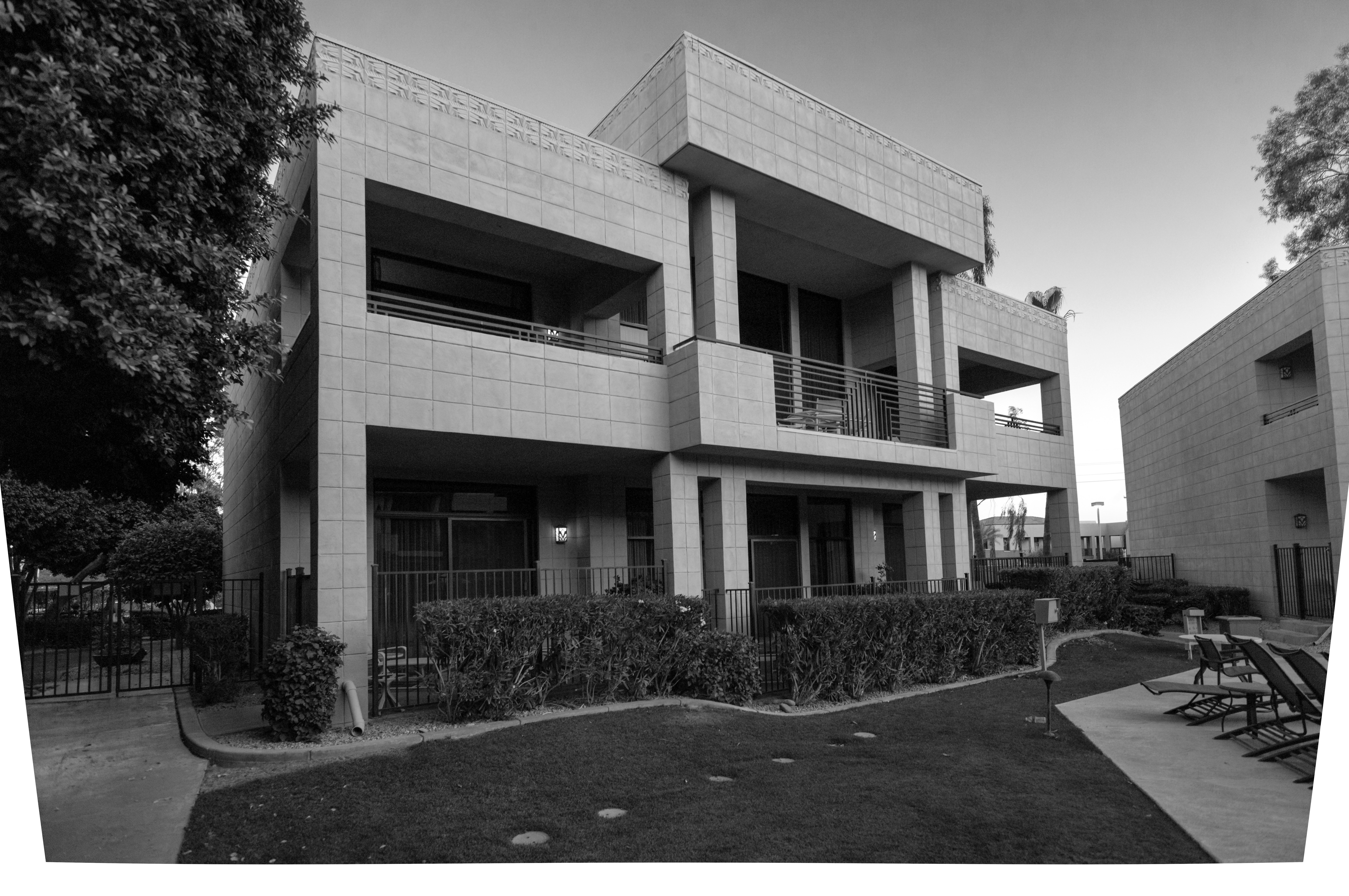

Leica M, Leica S, Leica CLOfflineI've been testing the “upright” button and found it pretty amazing.
The first shot is purposely shot on an angle. None of these are cropped.
The second shot is merely using the “upright” button I discussed earlier. It does the job.
OK, I adjusted the sky a bit too.
Yes, you can adjust using “vertical” in LR4 but that doesn't do the job as well by any means when the camera was tilted and angled to begin with. That is shown in the third photo. I suspect that next we will have this software loaded into an iPhone app.
The cost of a good camera level is about $24. So this button on LR5 is worth $24.
