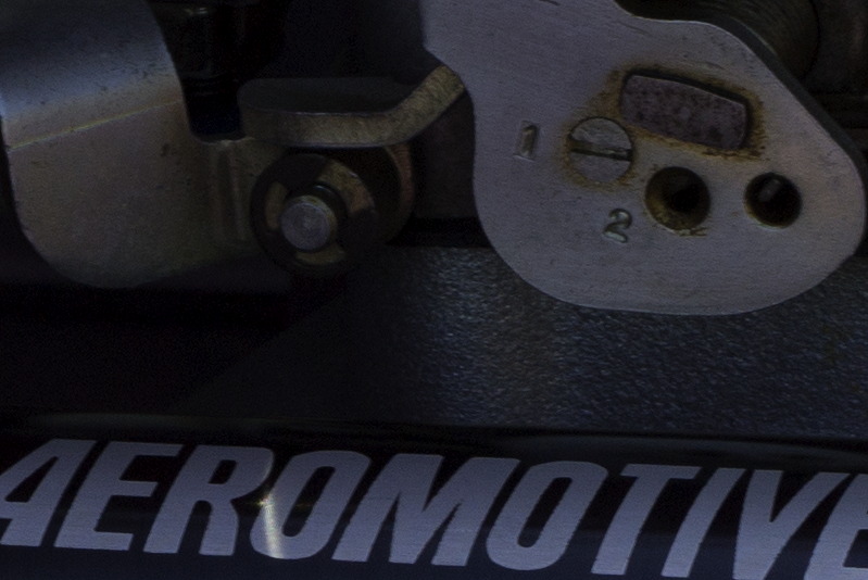

    Here’s the Pentax-67 100mm f/4 Macro.
    I ran into an acquaintance named Jim at the local Saturday farmers’ market, looking a little startled while sitting on the curb eating some kind of delicacy. Lens was wide open at f/4.
    Then I walked around the corner into a custom car show and found this purple Plymouth

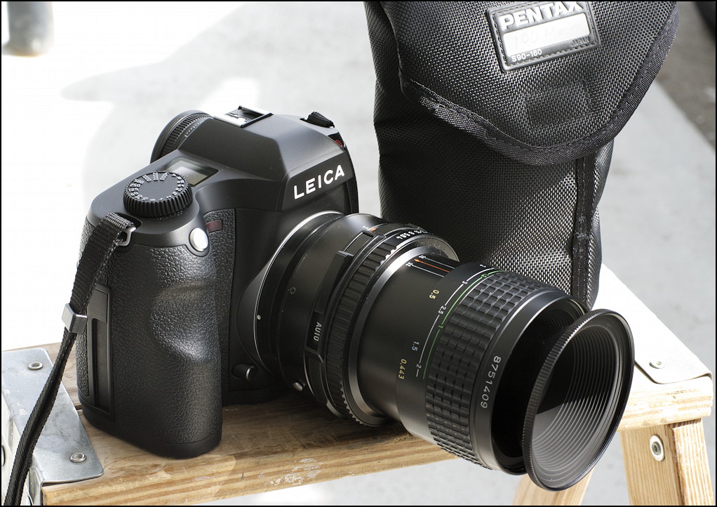

    Here’s a pic showing the Pentax 100mm f/4 Macro mounted. (Click for larger view)
