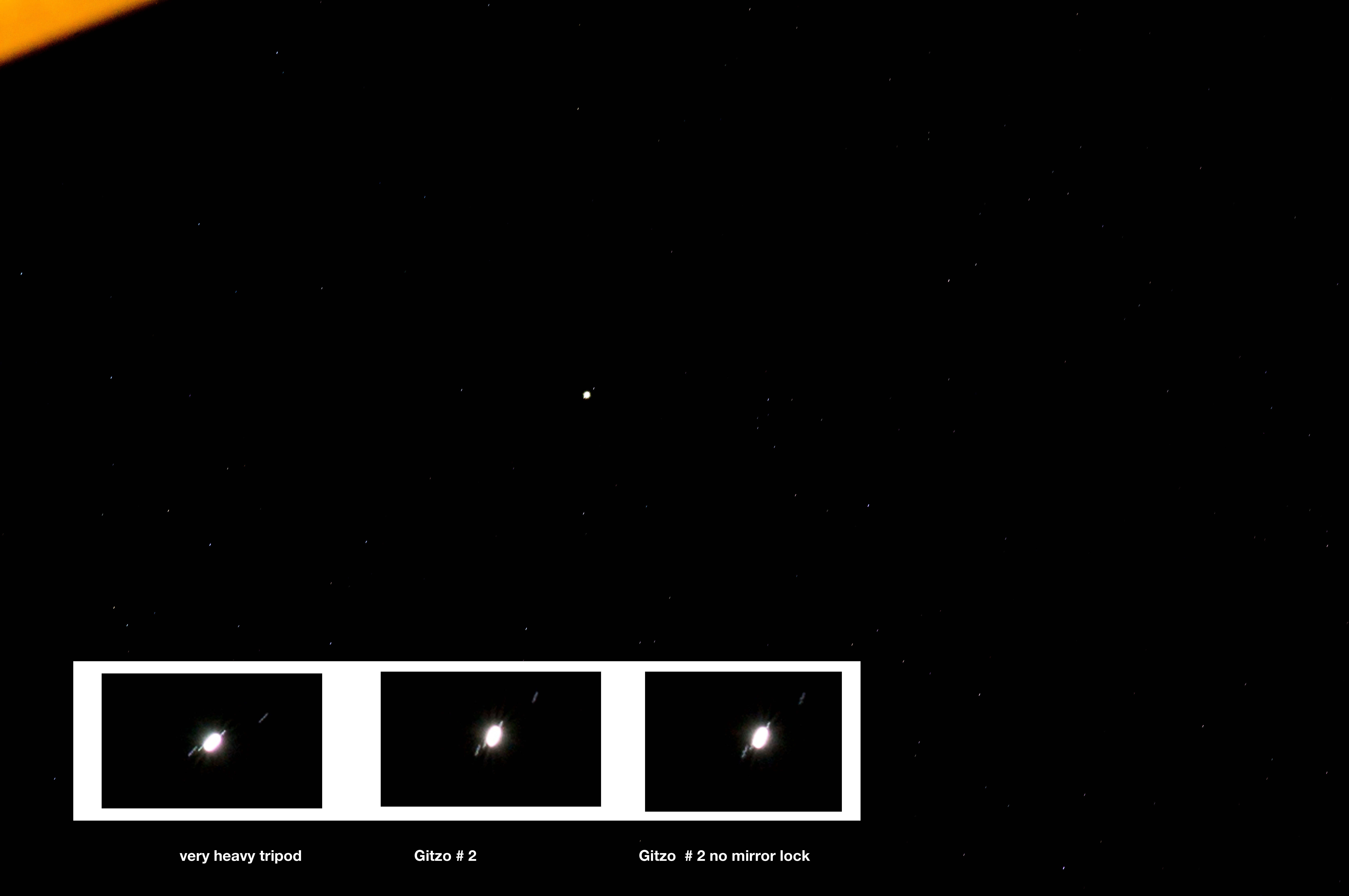

September 22, 2011 at 4:59 am #1004Jack MacDEstablished Member
Roger,
After telling you to do a test, I decided I should also. Especially after David expressed a bit of surprise that I would be going on his fall trip with such a light tripod as the Gitzo#2
Maybe if I had a 180mm I would go for the #3.I merely did an 8 second test shot of a star on a very heavy tripod that I would never hike with followed by the same shot with the Gitzo #2, also shot with a two second delay that flips the mirror first , and then a third shot on the #2 with no two second delay, merely pressing the shutter release directly. This is with a 120mm. The three insert enlargements are 6 times the full field shot that is the background. Without using the 2 second delay in the third shot, I can see a slight very slight wiggle in the middle of the tiny star trails.
A tribute to the damping of the S2, the differences are hard to detect. I feel I am safe with the #2 when using the 2 second delay.

September 22, 2011 at 2:45 pm #1005Jack MacDEstablished Member
Of course there is a difference in height with a larger than #2 tripod which may make a difference in getting the angle one wishes.
September 22, 2011 at 3:05 pm #1006David FarkasNewbie
Jack MacD;775 wrote: Roger,
JackInteresting test, Jack. Thanks for taking the time to carry it out and share the results.
You may want to see what happens at around 1/8th – 1/30th. This range tends to be the “danger zone” for mirror/shutter vibration (not just in the S2, but in SLR cameras in general). With a very long exposure of 8 seconds, any initial movement represents such a small fraction of the overall exposure time. Of course, when photographing stars, too long an exposure and you get trails (which is great it that is the intention, just not as good for testing camera movement).

September 22, 2011 at 3:14 pm #1007Jack MacDEstablished Member
I will try the test at those speeds tonight if it is clear. The star trails in a way help seeing the movement as one is observing any deviation from a straight line. Unless the camera motion happens to be on the same axis as the star movement. I’ll see.

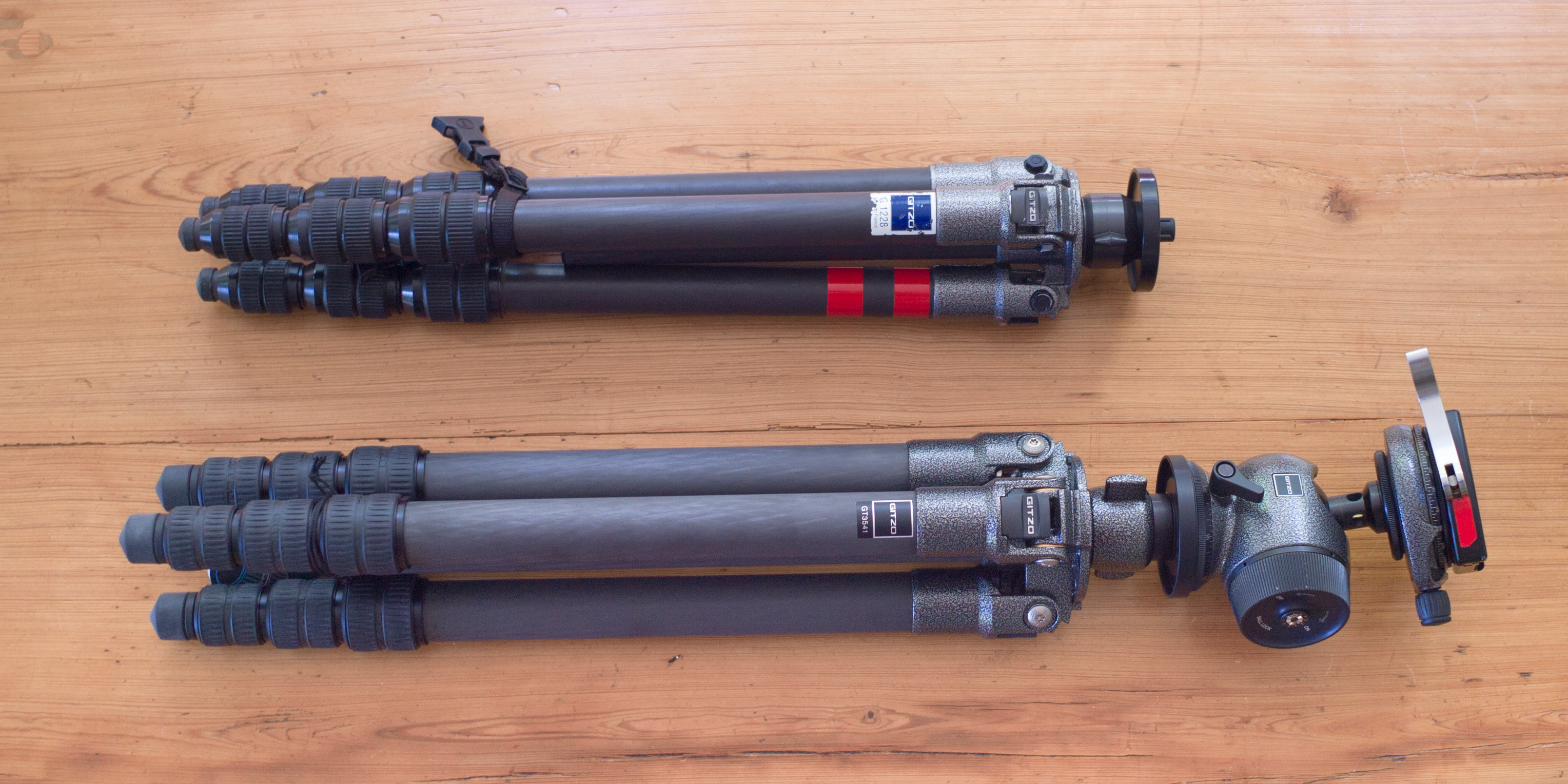

October 11, 2011 at 6:52 pm #1100Jack MacDEstablished Member
A report back from the Fall trip:
First, a quote from David Farkas, “I have already checked out all the alternatives with exhaustive testing. I know that what I end up with is expensive, but if you follow my recommendations you will have saved money skipping the intermediate steps on your quest for what works best for you.” I had to laugh, but he is correct.David recommended the really right stuff quick release system. I got it before the trip and was very pleased. Interestingly everybody had this mount, 90% with the lever release closure rather than screw tightening closure. It made for fast borrowing of others tripods too. It is the first quick release system that gave me confidence that there would be no accidental unwelcome release.

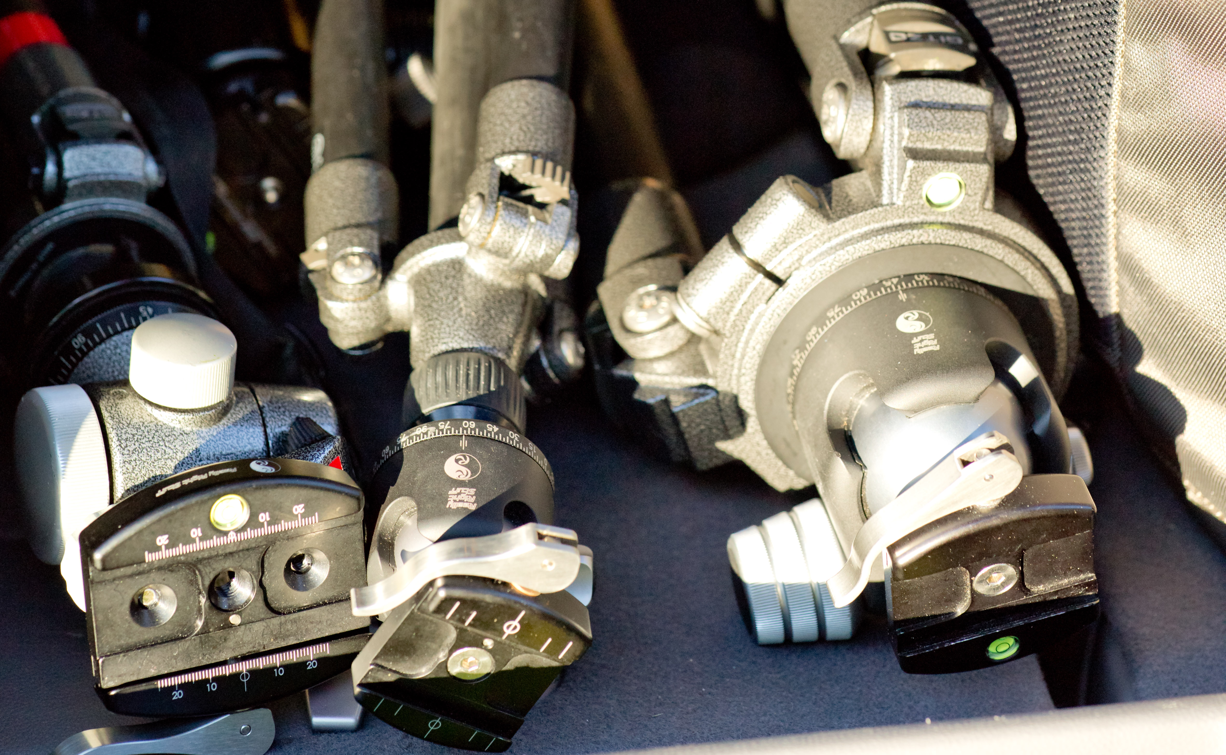

As you can see from this thread, David was recommending a Gitzo 3 series. In our van we had four tripods, all Gitzo, but the range included a #1, #2,#3, and #5. I had the #2 and it worked fine, but when I borrowed Joe’s #3, I found that the extra height was a plus for me. However I am 6’4″. The #5 would only be necessary if one were shooting with a 400mm lens that weighed a lot. Well, Mark was. The #1 was OK, but height limited. My #2 fit in my carry-on luggage perfectly with the ball head removed, and I will be willing to take it on casual trips, but the #3 can probably be carry-on too, if the top peeks out of my back pack.

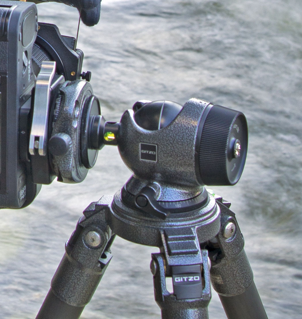

Several people had Really Right Stuff Ball heads, which worked quite well. You can see two versions of it in the tripod photo from the back of the van. After trying them versus David’s Gitzo ball head, shown in the photo, I decided I preferred the Gitzo, as long as it had the panorama head attached. My old Gitzo off-center head was a bit harder to use in comparison to more modern equipment. A bit too light for an S2, was wonderful for my M and I will move it to my #1. I will duplicate David’s set up going forward, including the #3 tripod. And yes Josh, I will buy it from Dale.
As you can see from the photo, David prefers using the head sideways for vertical shots rather than the Really Right Stuff L bracket. He determined in his testing that the L bracket was not stiff enough for rigid support of the 180mm. I saw his point, but I hoped it was not as big a problem for my 120mm. Otherwise the L bracket is wonderful for the 35mm. It allows for near instantaneous switching from horizontal to vertical.
Finally, as to when to use a tripod: I am not one who feels a tripod is necessary for all landscape shots. But when one is shooting in the dusk, you just can’t get the shot without one. The dusk shot shown elsewhere could not have been done without one. And of course, for rushing water to be captured with the “cotton” effect, that can’t be done hand held.
