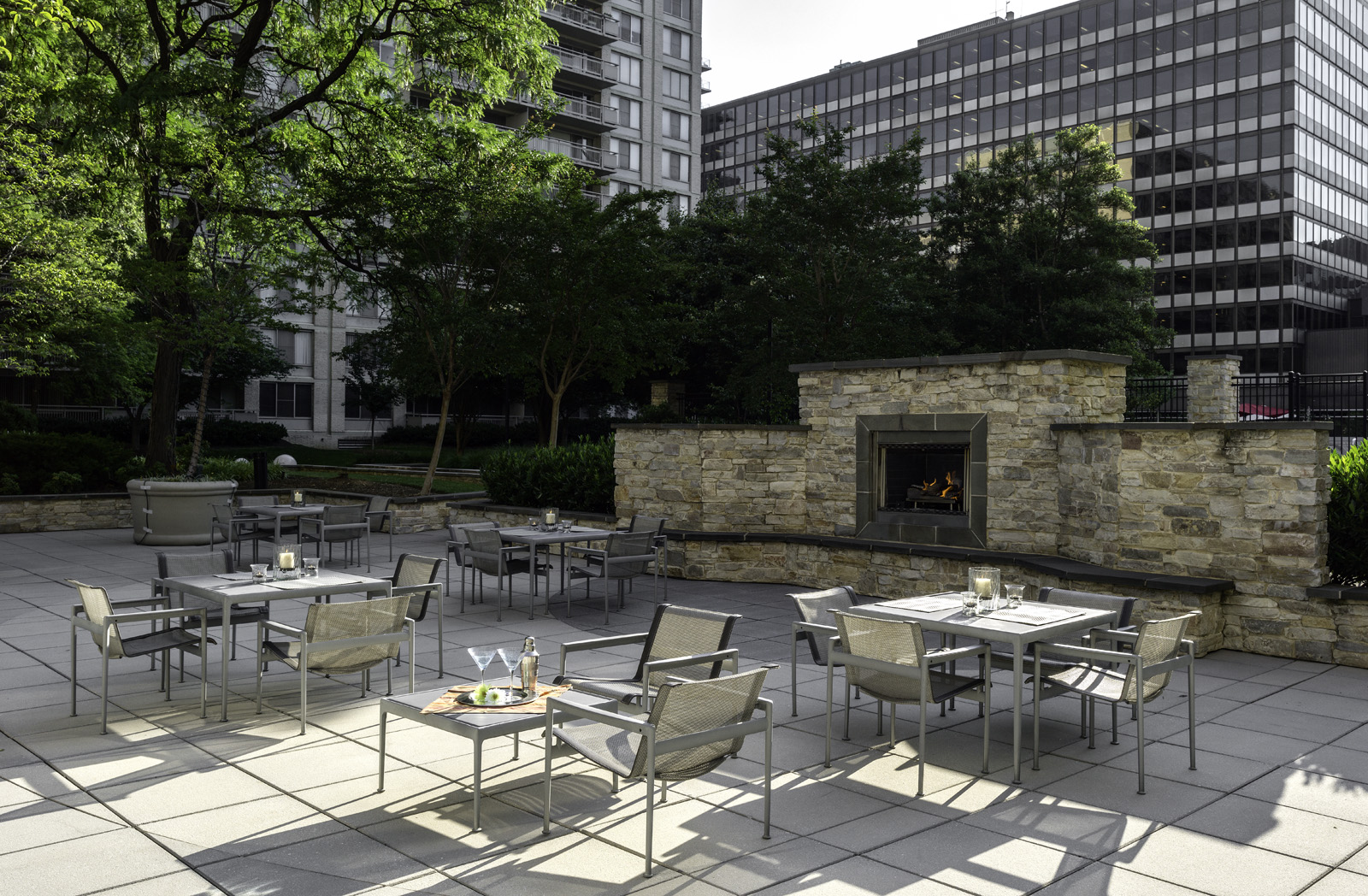

      I normally shoot architectural assignments with the shift lenses on the Nikon, but as it was not necessary in this case I decided to use the S2 with the 35MM lens. The dynamic range with the resolution and color rendering was great for this image. Very little post-processing was necessary. Take that D800! 😎

      aboudd;2446 wrote: I normally shoot architectural assignments with the shift lenses on the Nikon, but as it was not necessary in this case I decided to use the S2 with the 35MM lens. The dynamic range with the resolution and color rendering was great for this image. Very little post-processing was necessary. Take that D800! 😎
      Nice to see the S2 is working out well for your paid jobs in addition to the ones just for fun!

      Hi David,
      I intend to use it as much as I can on assignments when the situation allows. If there was a shift lens I could eliminate my Nikon kit altogether. πŸ™

      aboudd;2464 wrote: …If there was a shift lens I could eliminate my Nikon kit altogether… πŸ™
      There have been mentions of Leica making a shift lens for the S system, but I don’t know where it is at on there lens road map. It would definitely open up additional uses for the S2. I would like one for landscape photography. It would be great to be able to eliminate the skewed trees when pointing the camera up slightly to get the composition you want. I often change to a portrait orientation to minimize the perspective effect on the trees.
