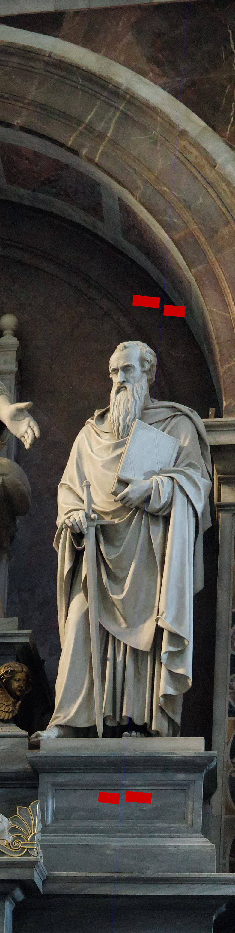

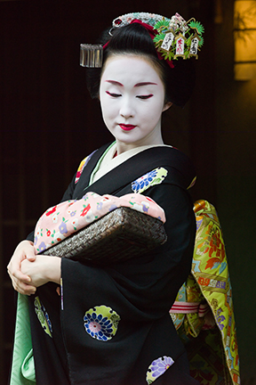

    Going through some of my recent pictures, I noticed this purple line and wanted to know if others have noticed it as well on their cameras or if I am doing something wrong. I am attaching pictures taken by two different lenses (35/120) so it is not a lens problem. It does not appear in all pictures but mainly in low light/pushed two+ stops. I do not see it at all when I have used good light.
    Thank you,
    Arif

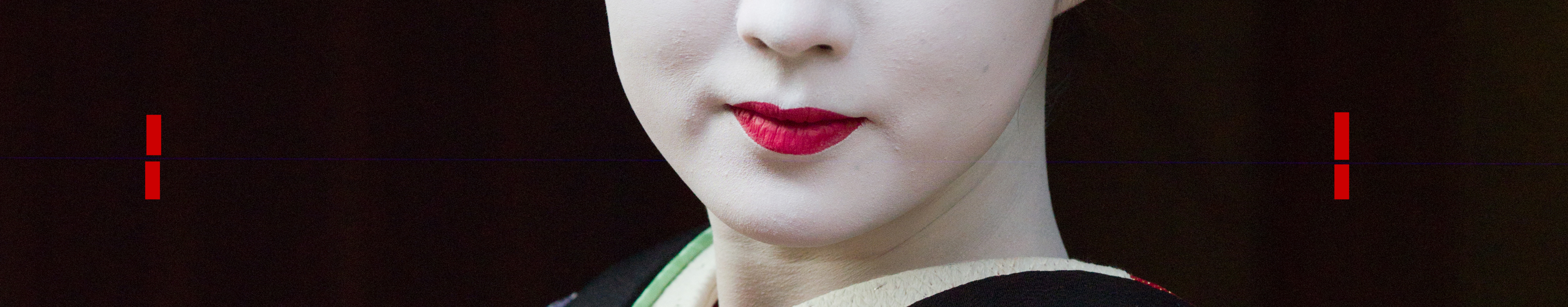

  • #1774
    Arif
    Sorry, I should have highlighted the line in the 100% crops which are reattached. Please find them between the red boxes in these pictures (you may have to double click them twice to see at 100% resolution).
    Apologies for the inconvenience,
    Arif
  • #1775
    constable
    Hi Arif
    OKnow I see it. I’ve never sen anything like that I’m afraid. Is it in the DNG?
    Ed
  • #1779
    andyc
    Hi Arif
    is this just a single line at exactly the same position each time ??
    it looks more like a fault with the Sensor if it is.. unlike a scratch which would be more prevalent the more you close the aperture on a lighter background.. I have not seen this before on a S2 but you need to have it checked out.. how old is the Body as a few Sensors became cracked in the early supplies including one of mine.. Andy
