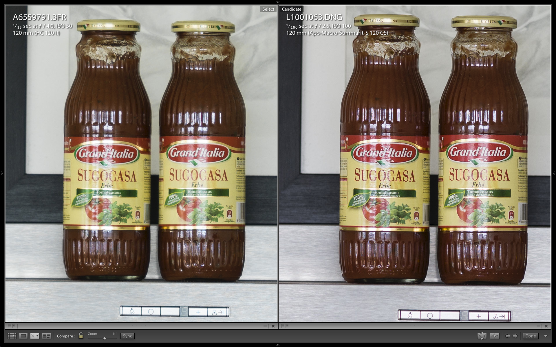

    RVB
    I digress but I was curious about how the S120mm compares to the HC120mm mk2 ,the parameters were tightly controlled and these are wide open shots..(this is @100%)
    But the image speaks for itself..
    Rob

    peterv
    Impressive test results, Rob! I would not have expected the difference between these two lenses to be that obvious.
  • #4800
    RVB
    peterv;8506 wrote: Impressive test results, Rob! I would not have expected the difference between these two lenses to be that obvious.
    Peter I have a few HC lenses,I will probably sell them,the S lenses are a step up,no doubt about that.. The blad lenses work pretty well when stepped down to be fair,but DAC is more important for HC IQ than it is with S glass..
