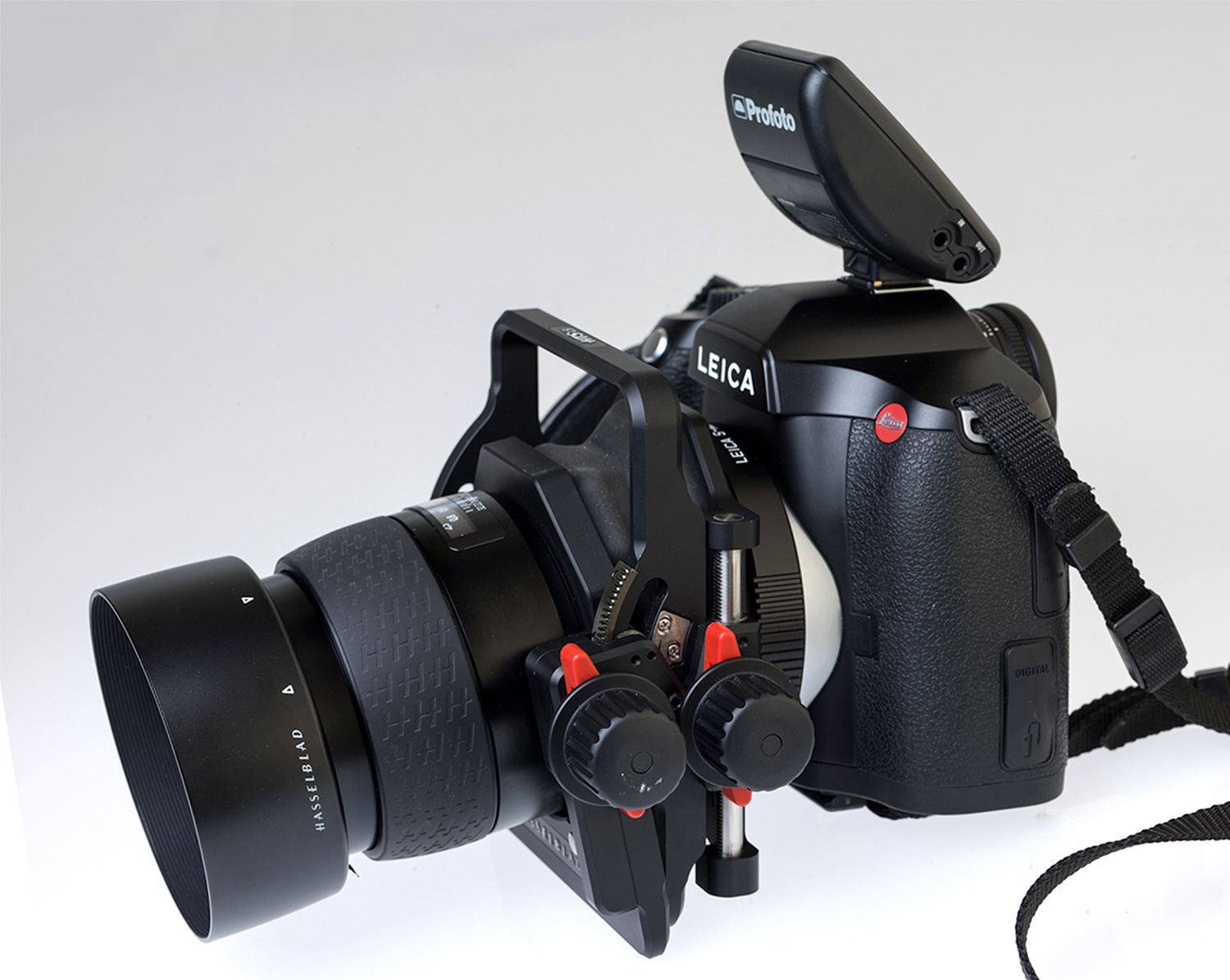

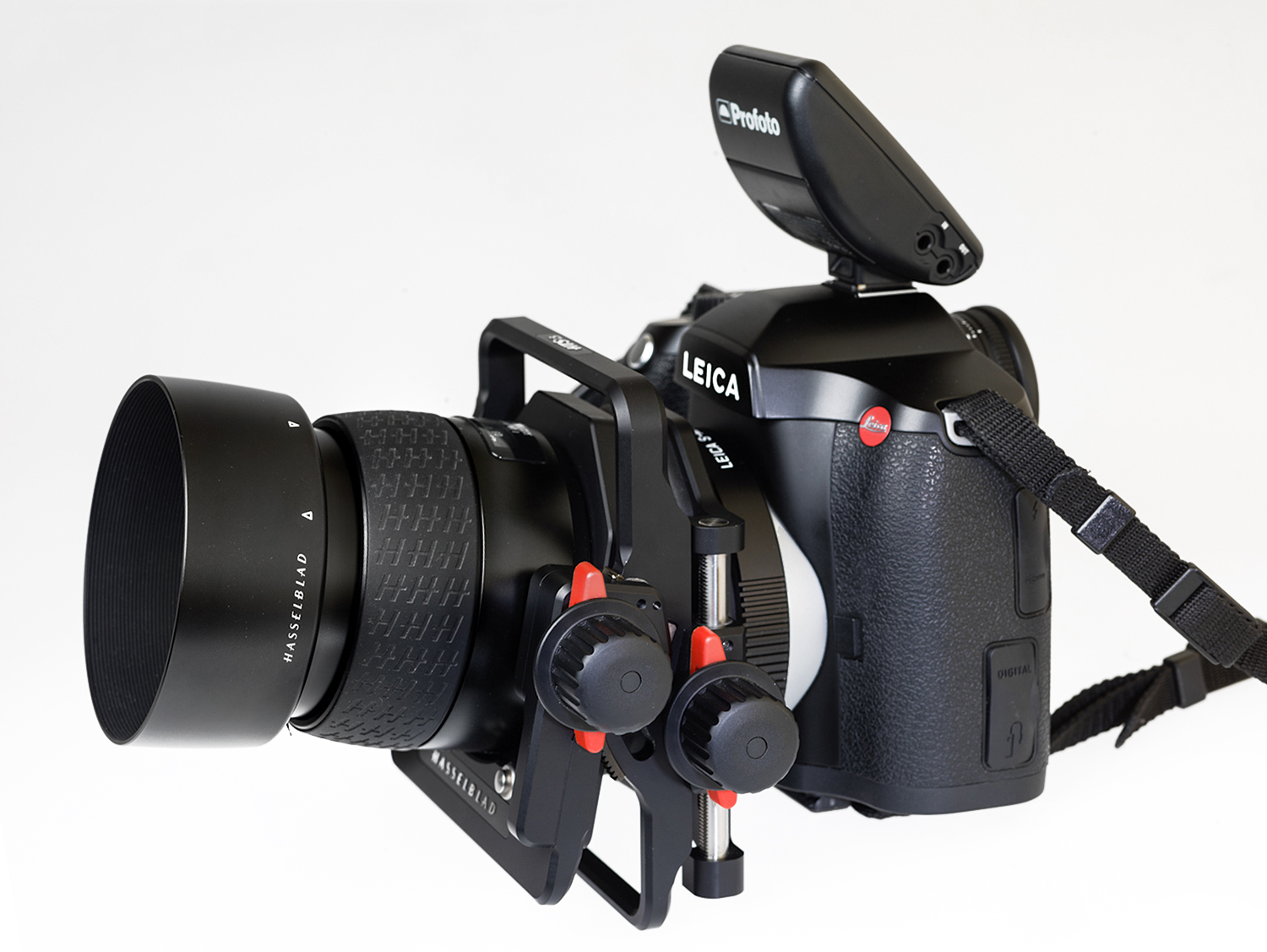

So I decided to try it. Went on and off smoothly. Checked everything to see if there was any scuffing or anything … nothing.
Mounted the HC100/2.2 Turned on the S2 and everything activated just like usual.

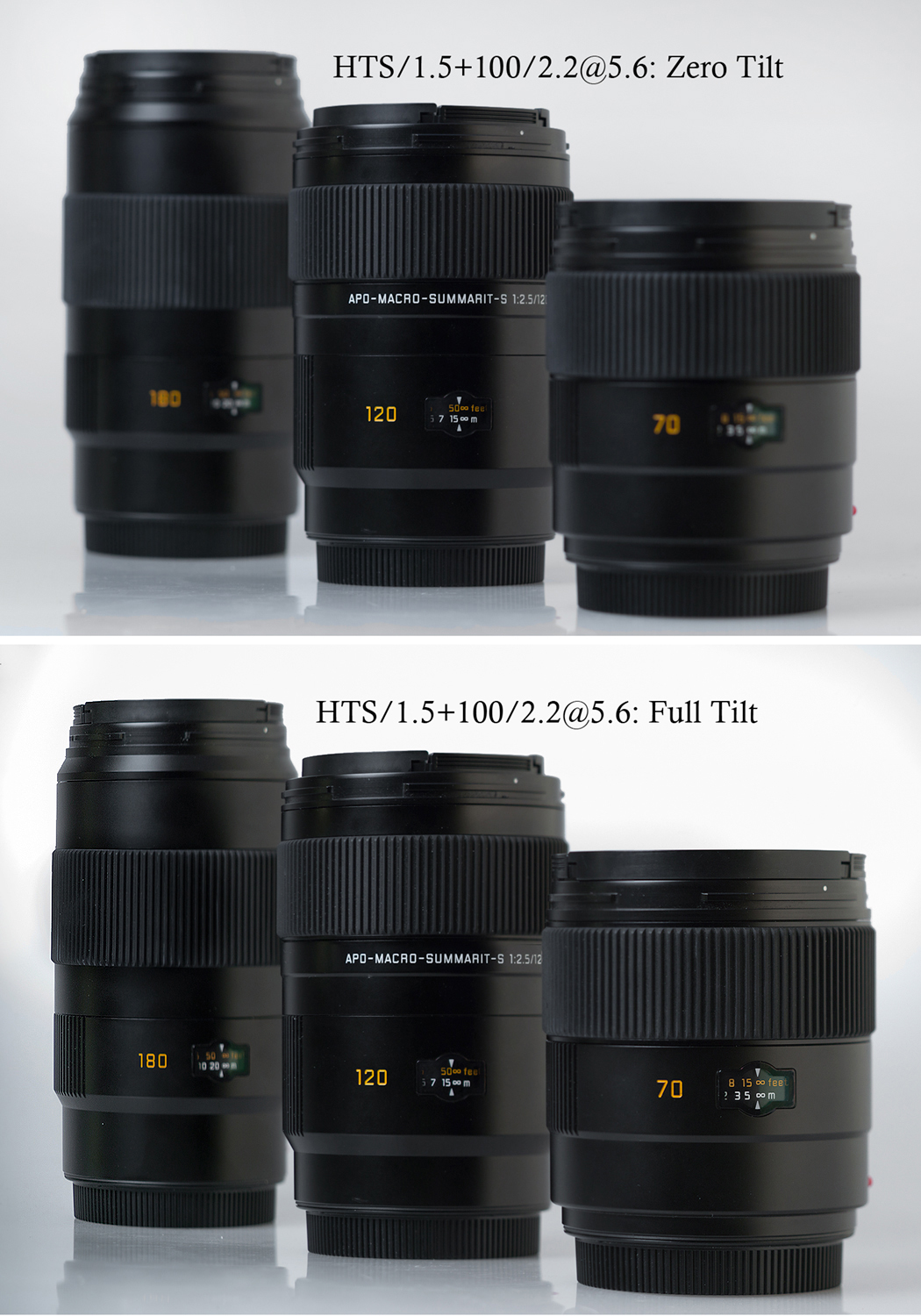

Set up a little test with three staggered S lenses set 14″ front to back, rotated the HT/S for horizonal tilt. Selected f/5.6. Shot one with zero tilt focusing on the lettering of the middle lens, then another with full tilt focused in the same place. Very narrow DOF at Zero, and almost full DOF with tilt. f/8 would have made it perfect and still avoided de-fraction.

No color cast difference between zero and max tilt.

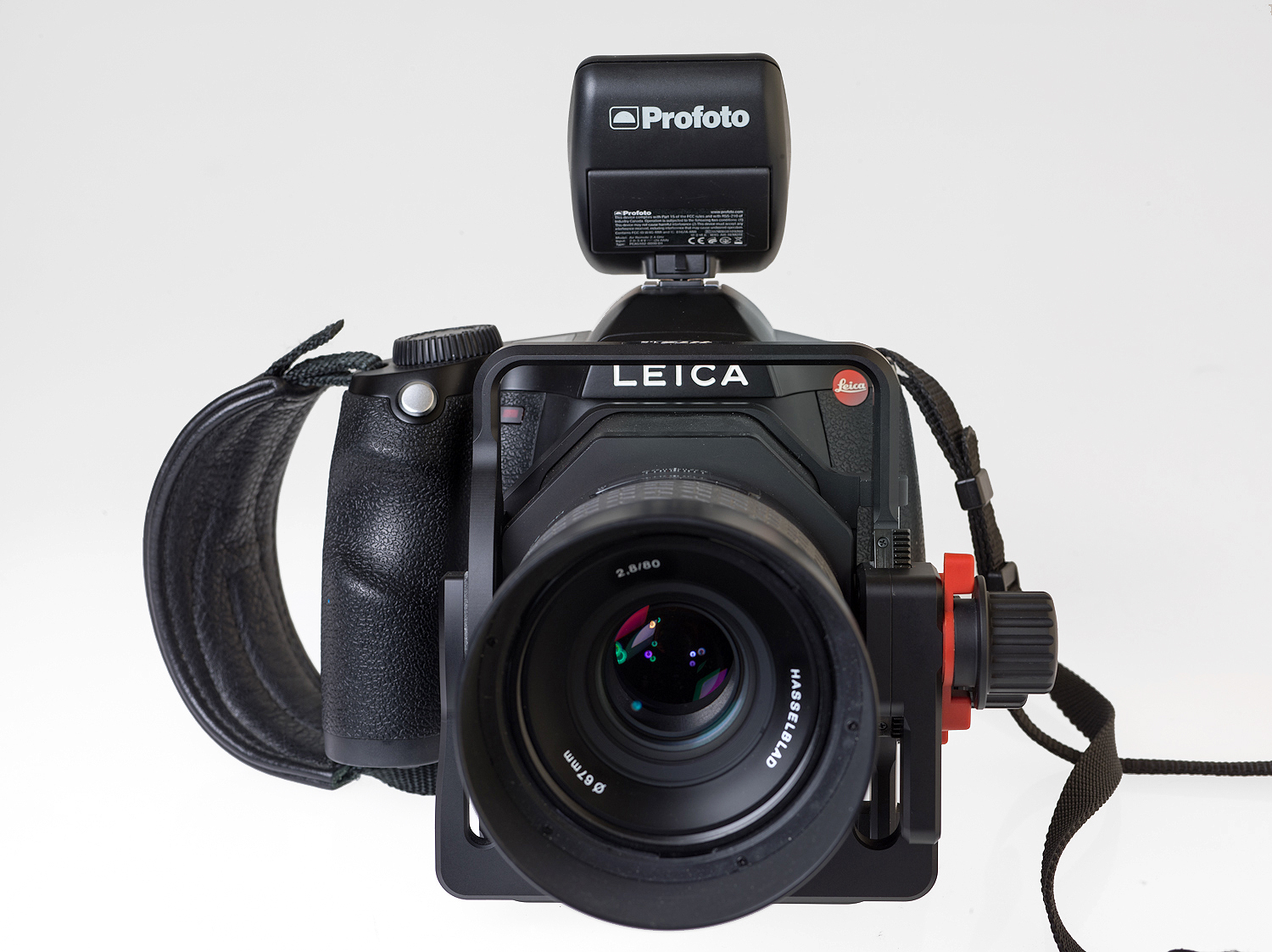

It works fine but does not retain AF … all it does is hunt. f/4 X 1.5X is probably the reason … to small of a maximum aperture … to dim especially with movements applied. Same for the 50/3.5 … although it would occasionally grab focus.

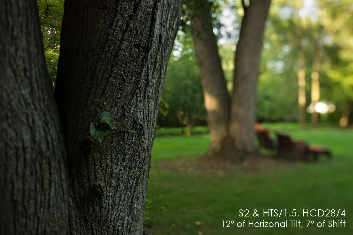

For example, table top DOF like the shots of lenses above, or like the WA shot below to throw part of the image OOF that otherwise would be difficult to achieve with the 28mm even if shot wide open.

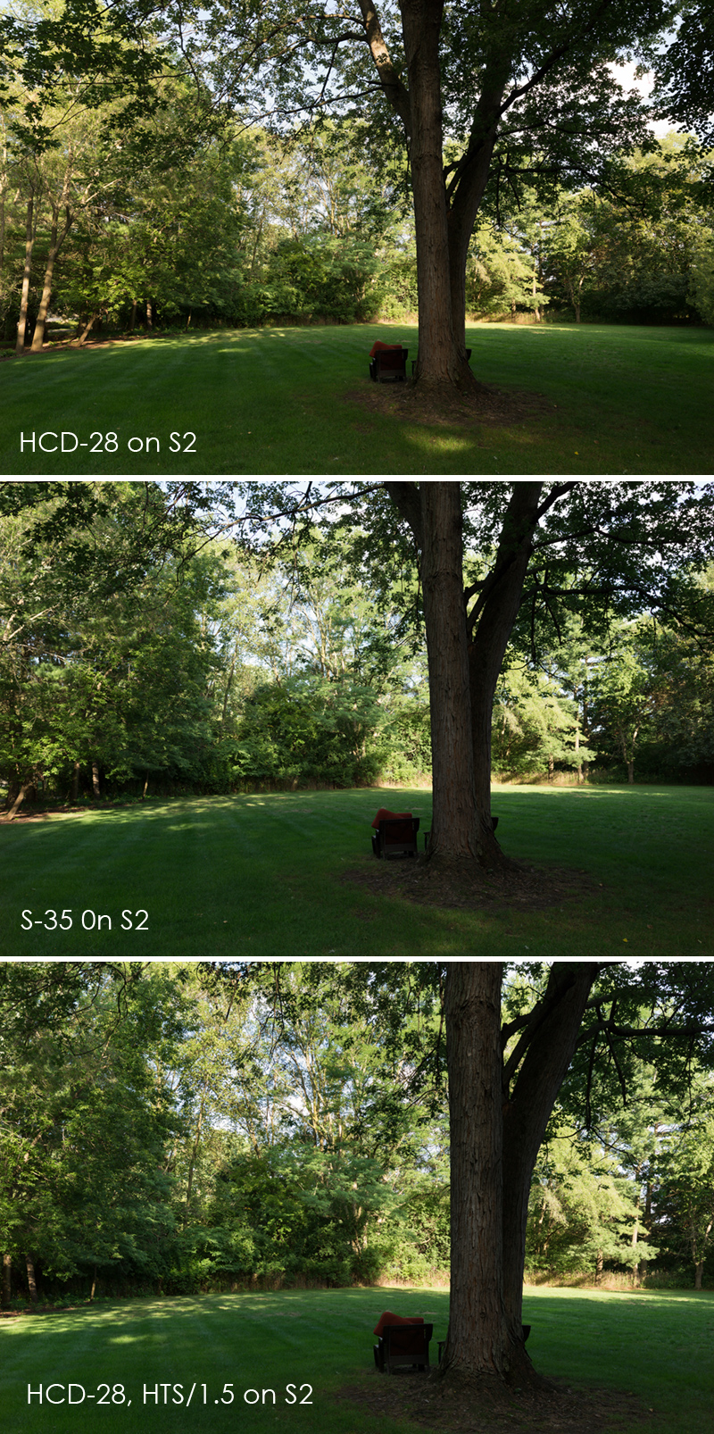

Here is a sample of that, and a three part image showing field of view covered by the 28 alone on the S2, the S-35, and then the 28 on the HTS/1.5 … it is still pretty wide @ 40mm … but nothing like a 23mm on a view camera etc.
