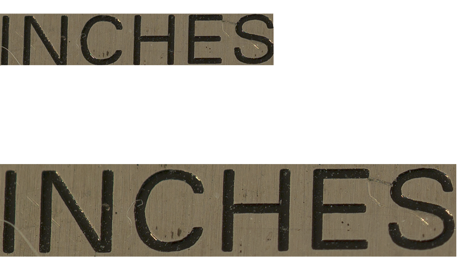

Although this might be deemed heresy and reason for forthwith interdiction, I thought that this might be of some interest here. This morning I placed ( dare I say it??) a Canon 500D Diopter in fromt of the 120 as a quick test. Posted below are crops of the same image shot with the bare 120 and with the 120 / diopter combination at minimum focusing distance with both displayed at 100% in PS5… for what it my be worth.
Douglas Benson
