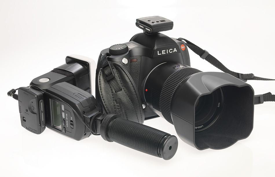

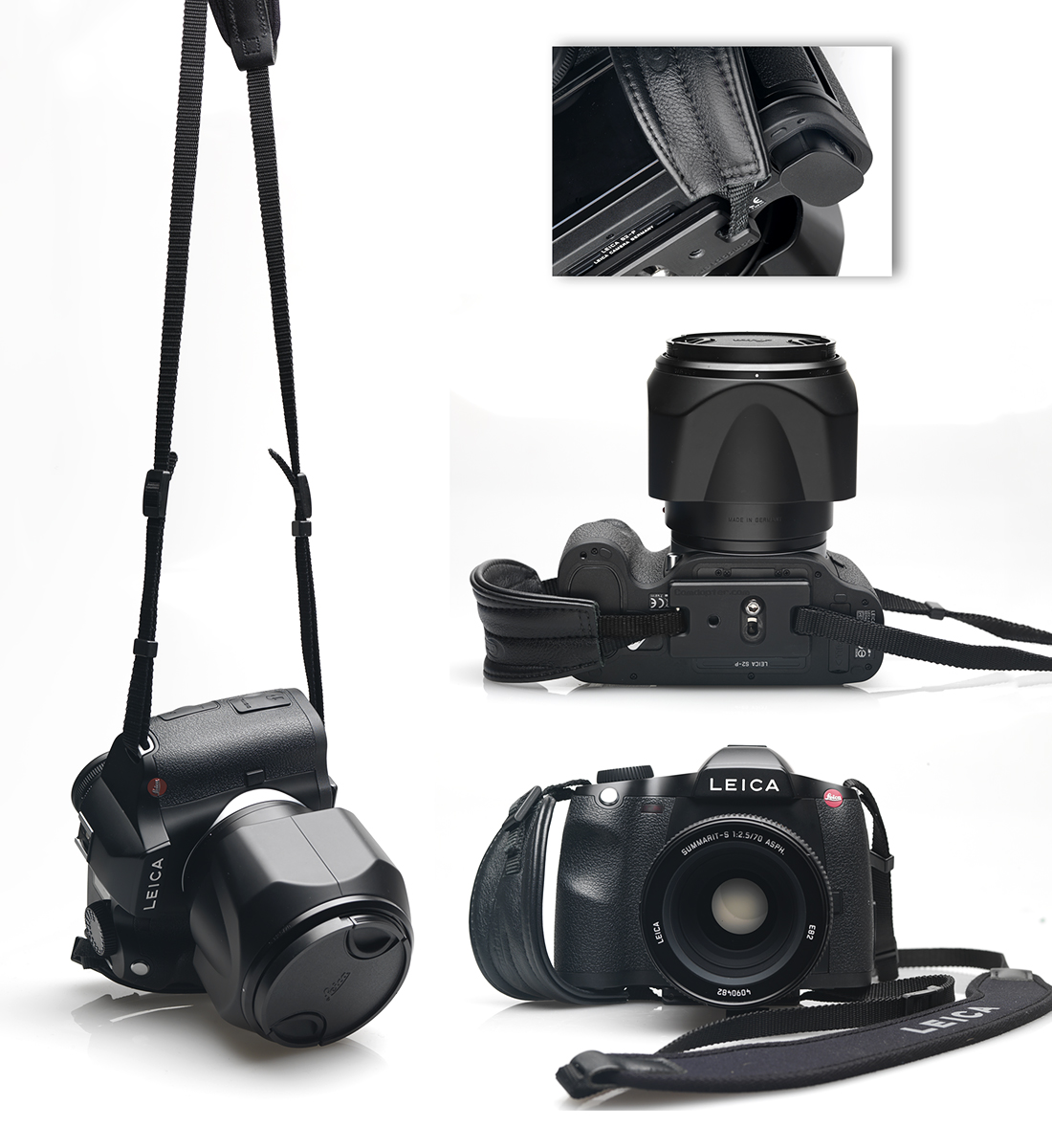

    Fotografz, I didn't find the answer about the handstrap. I am probably going to buy S2 and very interested about this handstrap. Is it Leica's or some third parties strap? – vintola –
  • #1637
    vintola;1441 wrote: Fotografz, I didn't find the answer about the handstrap. I am probably going to buy S2 and very interested about this handstrap. Is it Leica's or some third parties strap? – vintola –
    It is a Camdapter handstrap:
    http://camdapter.com
    I use one on each different camera I have. They come in basic black leather as shown on my S2 above, or a choice of some fun finishes (I use a Python Grey one on my Hasselblad H camera, which is also grey :-).
    The base I use is the Arca Neoprene Adapter … a Quick-Release base plate that fits an Arca QR system. It has a “dual Lug” design that allows you to have a hand strap AND a shoulder strap. The Arca base allows use on any Arca based tripod or Mono-Pod head.
    If you use a Really Right Stuff lever clamp for your QR, then the one to use is the Arca Plus Adapter.
    Also available in Standard and Manfroto base plates.

    Thank You fotografz. Probably the Leica's own handstrap is suitable only if using the additional handgrip/battery compartment. – vintola –
    Hi Marc,
    by the way thanks for the tip – I have that strap on my camera for some months now and it works really good. Tom
  • #1738
    Jheroun
    Marc,
    That's a very smart set-up. I've tried to locate the grip you have on the SF58, but no luck. Where did you get it?
    Thanks,
    Joe
  • #1744
    B&H Joe,
    http://www.bhphotovideo.com/c/product/605593-REG/Kirk_AG_1_AG_1_Action_Grip_for.html
    You'll need a ARCA type quick release plate in the camera … or the dual lug ARCA version available on the Camadapter site.
